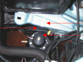

- LovatoFastVaporizador.PNG (194.67 KiB) Viewed 74229 times

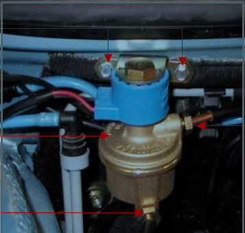

- LovatoFastEletroválvula.PNG (255.33 KiB) Viewed 74229 times

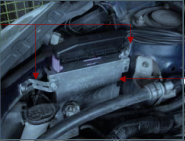

- LovatoFastCentralina.PNG (225.08 KiB) Viewed 74229 times
